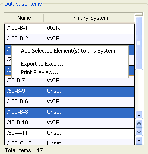

When a SYSGRP is highlighted in the System Explorer single or multiple elements from the list of Database Items can be added to that SYSGRP.
In the Database Items pane highlight the required elements (use the CTRL key while left-click to make multiple selections) and then right-click and select Add Selected Element(s) to this System.
The Main Systems and Owning Systems tabs updates to display the items have been added to a system.
The list of System Members is also updated to reflect the addition.
