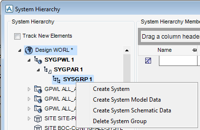

Create : System Hierarchy : Create System
The text fields are the same as those on the Create System Group World and Create System Group Area windows.
Select Create System Model Data to display the Create System Model Data window:
Allows the Function and Description attribute values to be set for this system. These are copied to the Function and Description attributes of any element assigned to that system (if these attributes are not already set). A SYSMDA element is created under the SYSGRP to store this data.

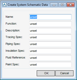

Select Create System Schematic Data to display the Create System Schematic Data window:
