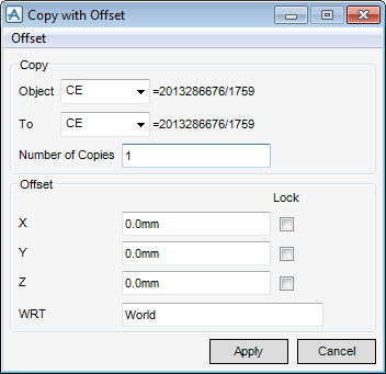

On the Home tab, in the Common group, click Copy Element, select With Offset from the drop-down list to display the Copy with Offset window.
To specify the offsets as being the same as those between two existing design items, use the Offset menu options to measure the required distances. Use the submenus to specify the type of element the user wants to measure from and the type of element the user wants to measure to. The choices in each case are:
Select the required options from the Offset menu and, when prompted, pick the two points between which the offset is to be measured. The calculated distances is entered in the Offset X,Y,Z text boxes automatically.
Click Apply to create the three offset copies, the user is prompted to confirm if the user wants to retain the copies (if it is correct in the graphical view).
Click Cancel to discard any changes and to exit the Copy with Offset window.
