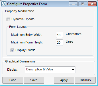

The Properties Settings window allows the user to control the appearance and behaviour of the Modify Properties window, which is used to edit property settings.
On the Project tab, click Options, click System, click Properties to display the Configure Properties window. The user can Load the previous properties settings or Save the current settings.
Select Dynamic Update check box to toggle controls when an element is updated as its properties are modified.
If Dynamic Update check box is selected, the element is updated every time a property setting changes. It is convenient for simple design items, but can give slow performance if a large number of rules have to be executed for each update.
If Dynamic Update check box is not selected, the element is updated only when apply on the Modify Properties window is used.
The Form Layout pane determines the appearance of the Modify Properties window:
In the Graphical Dimensions pane, Display controls how the design parameters are displayed in the 3D View (when requested). The user can select the following options from the drop-down menu:
