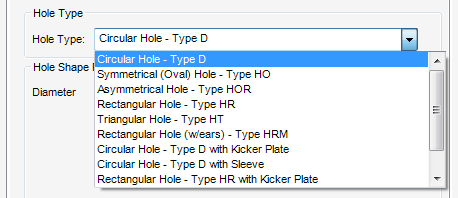

The project can be configured with additional hole types with sleeves and kicker plates. If these have been added to the project, the hole types with sleeve and kicker plates appear in Hole shape selection,
Type
drop-down list.

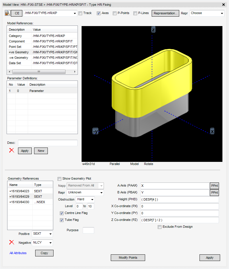

The virtual hole geometry must be made from an SEXT element in the catalogue.
The SEXT element must be orientated in the Z direction PAAX = X and PBAX = Y.
The SLOO of the SEXT must have its PURP attribute set to HPGE.

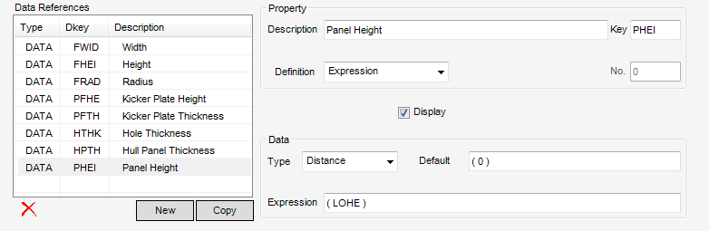

There must be a DATA object with its key set to HTHK.
There must be a DATA object with its key set to PHEI and must be set up as follows:

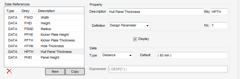

Any design parameters for extra material must have a DATA object in the data set with the key attribute beginning with the letters PF. There must also be a DATA object in the data set with its key set to HPTH.
