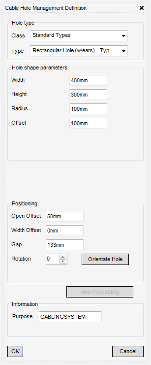

The Cable Hole Management Definition window displays the different input criteria depending on the Hole Shape Selection Class.
If the Class is set to Standard Types then the Cable Hole Management Definition window displays as follows:
After selecting the Class the user must select the hole shape Type. If the Standard Types Class has been selected then a list of predefined types can be selected. Otherwise the Type drop-down list changes depending on the data configured by an administrator in the catalogue database.
Depending on the hole shape Type selected, the input criteria under Hole shape parameters is changed. For example if Rectangular Hole has been selected as the hole type then the user is prompted to enter numeric values for the Width, Height and Radius of the hole.
Click OK on the window creates an entry in the Hole Management system.

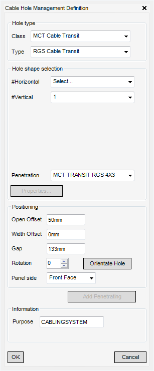

In this example the Class has been set to MCT Cable Transit which is a Selection Table that has been configured in the catalogue database.
The Hole Shape Parameters section of the Cable Hole Management Definition window previously visible when the Class was set to Standard Type is now replaced by the Hole shape selection section. The drop-down lists represent penetration selection criteria defined in the catalogue database.
As the selections are made in the drop-down lists, the number of penetrations available for selection in the Penetration drop-down is filtered to those penetration components that match the current selection criteria. If the Penetration drop-down contains no entries then there are no items in the catalogue that match the current selection criteria.
The Properties option displays the standard catalogue component parameters window where any user defined dimensions of the penetration piece are defined.
Click OK on the window to create an entry in the Hole Management system.
