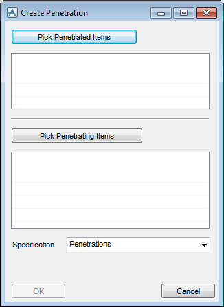

To request a cable way penetration, on the Cabling System tab, in the Penetrate group, click Create Penetration to display the Create Penetration window.
When the user clicks Pick Penetrated Items, the user is prompted to identify one or more items to be penetrated with a Managed Hole. If an item already in the Penetrated Items list is selected, it is removed from that list.
Click Pick Penetrating Items, the user is prompted to identify one or more penetrating items to pass through a Managed Hole. If an item already in the Penetrating Items list is selected, it is removed from that list.
The Single penetrations option creates one hole request for each penetrating item. All penetrating items share the same hole definition parameters.
The Merged penetrations option requests a single hole shared by all of the penetrating items.
Click OK to calculate the position of each penetration and displays the Cable Hole Management Definition window.
