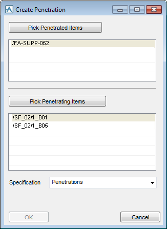

A HVAC Penetration is requested, on the HVAC tab, in the Penetrate group, click HVAC, select Create Penetration from the drop-down list to display the Create Penetration window.:
When the user clicks Pick Penetrated Items, the user is prompted to identify one or more items to be penetrated with a Managed Hole. If an item already in the Penetrated Items list is selected, it is removed from that list.
Click Pick Penetrating Items, the user is prompted to identify one or more penetrating items to pass through a Managed Hole. If an item already in the Penetrating Items list is selected, it is removed from that list.
Click OK to calculate the position of each penetration, and to display the Hole Management Definition window. Refer to Hole Management Definition for further information.
