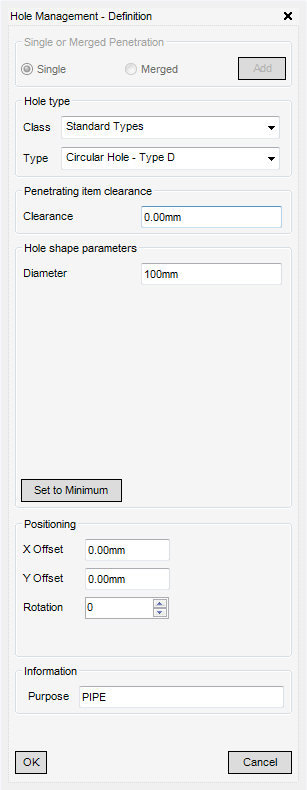

The Hole Management Definition window allows the user to specify what type of hole (or holes) are created in the penetrated item.
The Hole Management Definition window displays different input criteria depending on the Hole Shape Selection Class.
If the Class is set to Standard Types then the Hole Management Definition window is displayed as follows:
After selecting the Class the user must select the hole shape Type. If the Standard Types Class has been selected then a list of predefined types can be selected. Otherwise the Type drop-down list is changed depending on the data configured by an administrator in the catalogue database.
Depending on the hole shape Type selected, the input criteria under Hole shape parameters is changed. For example if Symmetrical (Oval) hole has been selected as the hole type then the user is prompted to type the numeric values for the Width and Height of the hole. The Set to Minimum option can be used to try to find the set of minimum values that still creates a valid hole.
Note:
If multiple single penetrations are being created, the affected hole shape parameters become temporarily disabled after using the Set to Minimum option as each penetration can be of a different size and there is no guarantee as to which of the penetrations the displayed value(s) is corresponded.
Click OK on this window to create an entry in the Hole Management system, and creates a Penetration ATTA element on the pipe.

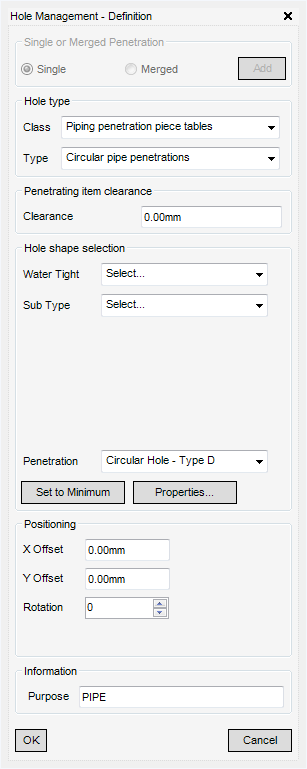

When a Selection Table has been selected in the Class drop-down then the window changes to display as follows:
In this example the Class has been set to Piping penetration piece table which is a Selection Table that has been configured in the catalogue database.
The Hole Shape Parameters section of the Hole Management - Definition window previously visible when the Class was set to Standard Types is now replaced by the Hole shape selection section. The drop-down lists represent penetration selection criteria defined in the catalogue database.
As the selections are made in the drop-down lists, the number of penetrations available for selection in the Penetration drop-down is filtered to those penetration components that match the current selection criteria. If the Penetration drop-down contains no entries then there are no items in the catalogue that match the current selection criteria.
The Properties option displays the standard catalogue component parameters window where the dimensions of the penetration piece are defined.
Clicking OK on this window to create an entry in the Hole Management system, and creates a Penetration ATTA element on the pipe.
