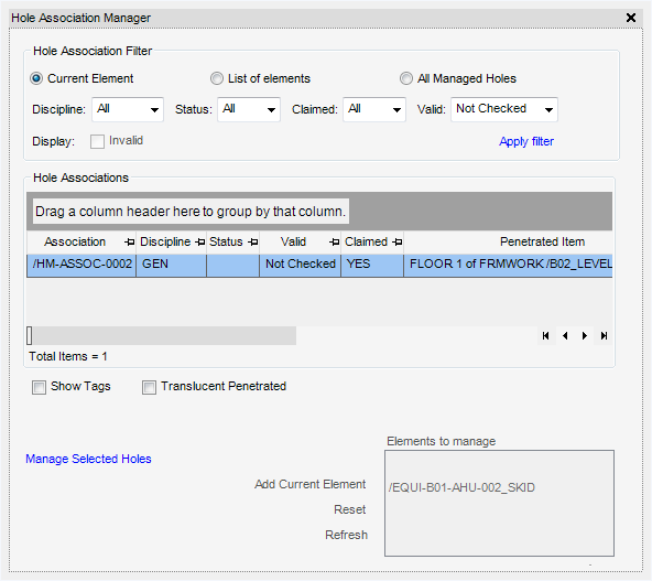

To access the Hole Management System, on the application name tab (for example HVAC), in the Penetrate group, click Holes, select Hole Manager from the drop-down list to display the Hole Association Manager window
The Hole Association Filter allows the user to search for Managed Holes and display the search results in the Hole Associations list. The filter criteria specify which Managed Holes are selected and displayed in the list. Once in the Hole Associations list, these holes can be inspected and modified.
Enables the Elements to Manage list box at the bottom right of the window.
Add Current Element adds the currently selected element to the items in the list. Elements can be removed from the list, right-click the element in the list and click Remove Element from the pop-up menu.
Reset clears the list and adds the current element.
Refresh starts the filtered search for all managed holes that reference any items in the list.
The user can select All the holes in the disciplines or specify a single discipline using the drop-down menu.
The user can select All the Status options or specify a single Status option using the drop-down menu.
The user can select All the Claimed options or specify a single Claimed option using the drop-down menu.
Refreshes the Hole Associations list according to the element and filtering options selected.

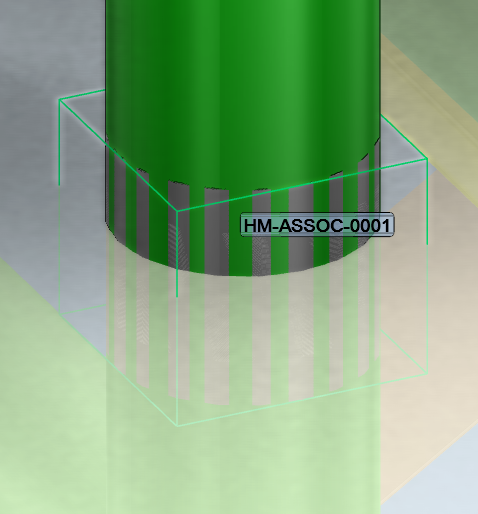

Click Show Tags check box to display labels in the 3D View around all the holes selected in the Hole Associations list.
Click Manage Selected Holes to display the Hole Management window.

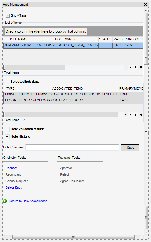

The Hole Management window consists of:
Click Show Tags check box to display the labels in the 3D View around the selected holes.

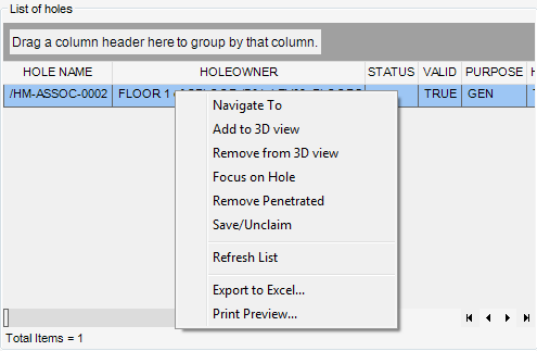

The List of holes pane lists the managed holes of the selected hole associations.

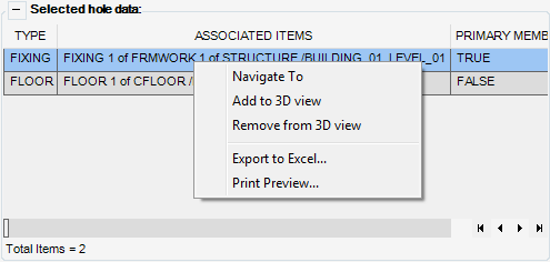

The Selected hole data pane lists more information about the hole currently selected in the List of holes.

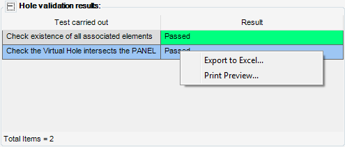

The Hole validation results pane displays details of associativity checks.
Each hole in the List of holes includes the results of the associativity check as either TRUE or FALSE in the VALID column. Further details of these associativity checks are available, display the Hole validation results fold up panel, which displays the Test carried out and the Result either PASS or FAIL. More detailed information can be found in the tooltips, hover the mouse over the result of a validation result.
A right-click pop-up menu provides facilities to Export to Excel file or Print Preview the displayed data.

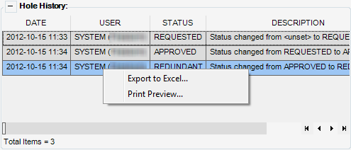

The Hole History pane displays the history of the currently selected hole.
Each hole in the List of holes displays the current status value on the Hole Management window but a history of changes to the status value during the lifetime of the hole data is also stored for reference. The full status history for each hole is displayed on the Hole History fold up panel.
The Return to Hole Associations pane returns the user to the Hole Association Manager window.
