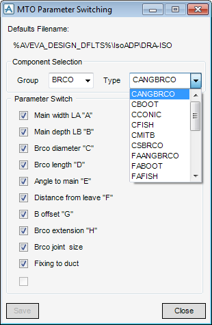

To modify the display parameters, on the Isometric ADP Defaults window, click More Defaults, select MTO Parameters from the drop-down list to display the MTO Parameter Switching window.
From the Type drop-down menu, select the component type from the list of available components.
To specify the display of parameter switches, on the Parameter Switch part of the MTO Parameter Switching window, select the required check box.
Click Close to close the MTO Parameter Switching window, if changes have not been made.
Click Save to apply the parameter switching defaults and then Close to close the MTO Parameter Switching window. The administrator is returned to the Isometric ADP Defaults window.
Click Cancel to discard any changes and close the MTO Parameter Switching window. A Confirm window displays asking the administrator to OK the cancellation. Click No to discard any changes and close the MTO Parameter Switching window. The administrator is returned to the Isometric ADP Defaults window.

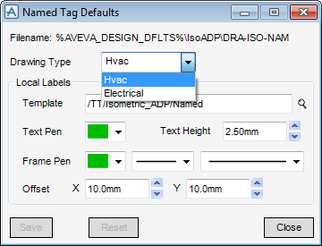

To modify the default settings for these labels, on the Isometric ADP Defaults window, click More Defaults, select Named Tags from the drop-down list to display the Named Tag Defaults window.
Select a Drawing Type from the drop-down list.
The functionality available from the Names Tag Defaults window is similar to that available from the Elevation Tag Defaults window. The Names Tag Defaults window differs from the Elevation Tag Defaults window in that it does not have a Connection Points part, Code field, Use Template or General Label text boxes. Refer to Elevation Tags for further information.

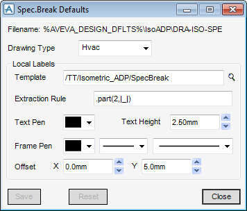

To modify the default settings for the symbols used on the main isometric view to indicate the point where any specification changes occur, on the Isometric ADP Defaults window, click More Defaults and select Spec Break from the drop-down list to display the Spec Break Defaults window.
Input an extraction rule in the Extraction Rule field to extract a string from the name of the HVAC or CWAY specification.
The functionality of the Local Labels part of the Specification Break Defaults window is similar to that of the Local Labels part of the Elevation Tag Defaults window. The Specification Breaks Default window differs from the Elevation Tag Defaults window in that it does not have a Code field, Use Template and General Label check boxes. Refer to Elevation Tags for further information.
