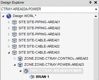

Click OK, to create a new Pipe and Branch element in the Model Explorer and display the Create Cable Tray Branch window, to define the branch, refer to Branch Element for further information.
