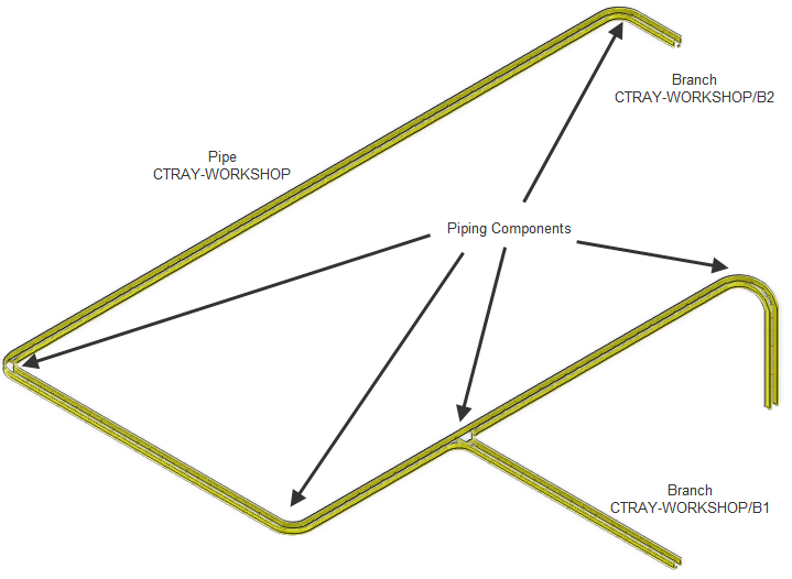

Cable Tray Specific Hierarchy
Below the zone level in the Cable Tray application, the cable tray specific elements are:
Pipe (PIPE)
The Pipe (PIPE) element(s) are administrative and can own a number of branches with a common pipe specification and have any number of ends (refer to
Pipe Element
for further information).
Branch (BRAN)
The Branch (BRAN) element(s) own a section of pipe (made up from cable tray components) with a known head and tail (refer to
Branch Element

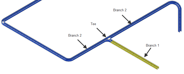

Cable Tray Component
The Cable Tray component element(s) are owned by Branch elements. These components dictate the shape and geometry of the cable tray. Cable tray components can run from the head to tail of the owning branch but can also be connected to other branches (for example - a tee component), refer to figure below and
Cable Tray Components
for further information.
