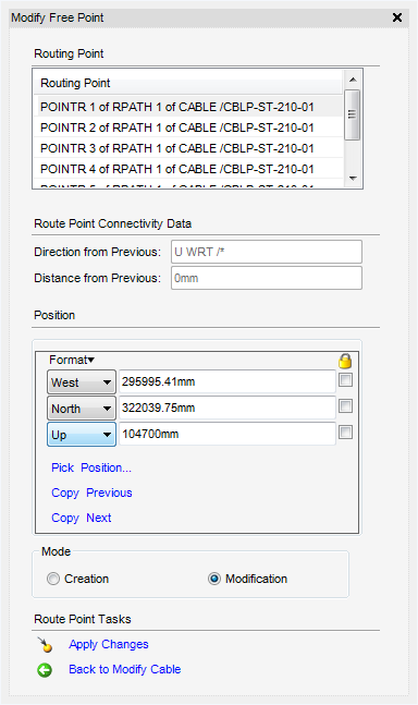

The Modify Free Point window is dual purpose window, which allows the creation or modification of a free point and acts as a task hub for all the options available for free points. The Modify Free Point window is automatically displayed populated with all the routing points of the cableway. To create a Free point, refer to Create Route Point.
From the Routing Point part of the Modify Free Point window, select the routing point to be modified. The Modify Free Point window is automatically populate with the attributes for the selected routing point.
The Route Point Connectivity Data part of the Modify Free Point window, displays the direction and distance of the currently selected route point from the previous one.
If a change in direction from the previous route point is required, in the Direction from Previous field, enter a new direction.
If a change in distance from the previous route point is required, in the Distance from Previous field, enter a new distance.
The Position part of the Modify Free Point window, displays the co-ordinates of the currently selected free point.
To modify the route point, click Apply Changes or to discard any inputs and return to the Modify Cable window, click Back to Modify Cable.
