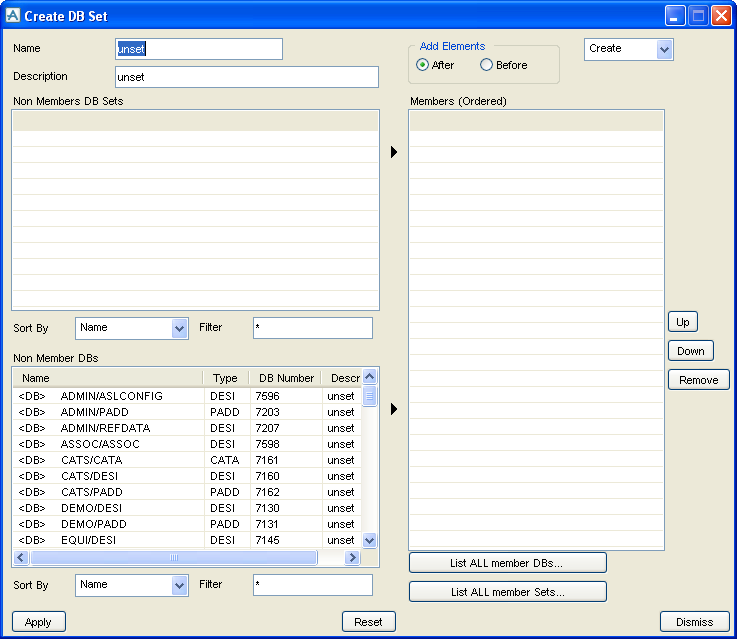

To create a DB Set, set the Elements option list on the Admin elements form to DB Sets, and click Create. The Create DB Set form will be displayed.
The Non Members DB Sets list shows all the DB Sets which have not already been added to the current set. The Non Members DBs list shows all the databases which have not already been added to the current set. The Members (Ordered) list shows all the databases that are part of the current DB set.
To add a DB Set or DB to the Members (Ordered) list:
In the Members (Ordered) list, highlight the element either immediately after or just before where you want to add the new DB Set or DB.
Use the Add Elements button above the Members (Ordered) list to show whether the new DB Set or DB is to be added After or Before the highlighted element.
Select a DB Set that you want to add from the Non Members DB Sets list, or a DB from the Non Members DBs list.
