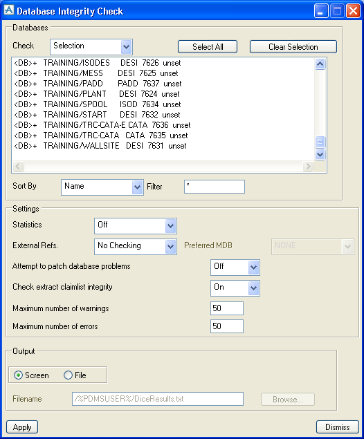

Select Utilities > Integrity Checker from the main menu, and the Database Integrity Check form will be displayed.
The Check options at the top of the form allow you to choose which databases you want to check. If the option button is set to Selection, you can pick the databases you want from the list. Select All selects all the databases in the list, and Clear Selection clears the selection.
The other options under Selection allow you to check:
The Settings options control the types of check carried out, and they are described in the following sections.
