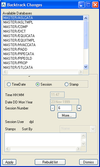

You can return a database to the state it was in at a previous session. You can backtrack using the Data > Change Management > Backtrack Changes option on the main Admin menu. The Backtrack Changes form will be displayed.
The Rebuild list button is used to update the list of databases. For example, if a new database has been created while the form is displayed, the list will not be updated until the form is closed and re-displayed, or click Rebuild list.
