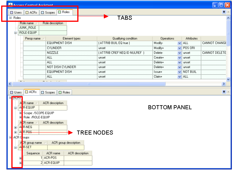

Data Access Control (DAC) : ACA Interface
Users - shows Users along with ACRs and ACR groups, and Teams together with Users grouped under these Teams,
ACRs - shows all ACRs defined in the database along with assigned Scopes and Roles, and ACR Groups,
Scopes - shows all defined Scopes,
Roles - shows all defined Roles with Perops belonging to those Roles.
User - contains children of type ACR or ACR Group representing ACR elements assigned to the User,
Team - contains children of type User representing Users involved in the Team,
ACR - contains children of types Scope and Role representing assigned access control right elements,
ACR Group - contains ACR nodes representing ACRs involved in the group,
Scope - nodes of this type do not have any child nodes,
Role - contains Perop nodes that the Role consists of,
Perop - nodes of this type do not have any child nodes.
