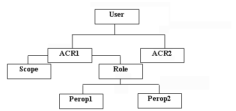

A Role is a set of Permissible Operations (Perops for short) which define the operations that can be performed on a given element type.
