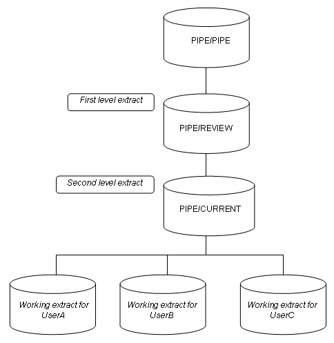

Setting up an Extract Hierarchy
Before you start creating extracts and working extracts, you should have a clear plan of how they will be used. You should maintain diagrams of the basic master extract‑working extract database organisation. These help when designing flush and release procedures, and defining MDBs.
Note:
The databases shown are all part of the same extract family, and so they will all have the same database number, for example 200.
