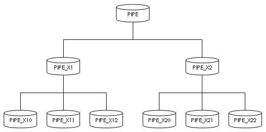

The following diagram illustrates an example of an extract family hierarchy:
In this example:
PIPE
is the Master and the Parent of PIPE_X1
PIPE_X1
is a Child of PIPE and the Parent of PIPE_X10
PIPE_X10
is a Child of PIPE_X1
The Children of PIPE are PIPE_X1 and PIPE_X2.
PIPE and PIPE_X1 are the Ancestors of PIPE_X10.
