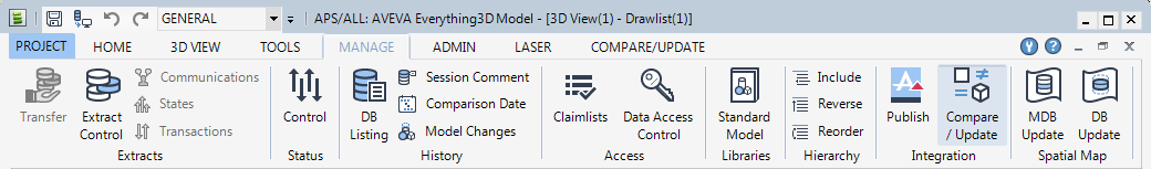

In AVEVA Everything3D™ Compare/Update is invoked by, on the Manage tab, in the Integration group clicking Compare/Update to display the Compare / Update window.

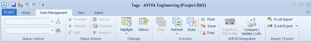

In Tags Compare/Update is invoked from the Compare / Update / Link option on the Data Management tab and then appears with a contextual tab holding the toolbar.

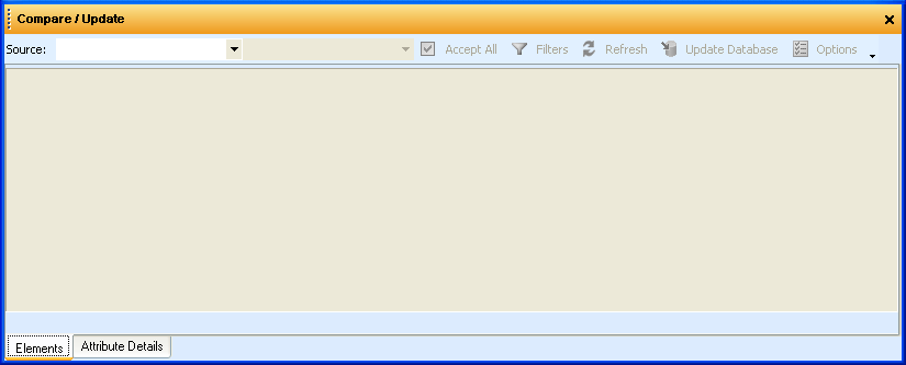

To start the add-in, select Display > Compare / Update The add-in is initially shown empty.
Click Login and select the desired Instrumentation, Electrical or P&ID project from the list.
Click Select, and when prompted, enter the username and password for that project. Then select the desired source group. The available groups from AVEVA Instrumentation or Electrical depend on the host module and can include Instruments, Loops, Equipment, Cables and Cable Catalogue items. The available groups from AVEVA P&ID are the P&ID types Equipment, Instrument, Line, LineFitting, Nozzle and Valve.
If element filtering has not been set up, the user will be prompted to do this now. Click Yes to display the Filter window and define one or more filters. Refer to Filter for further information.
