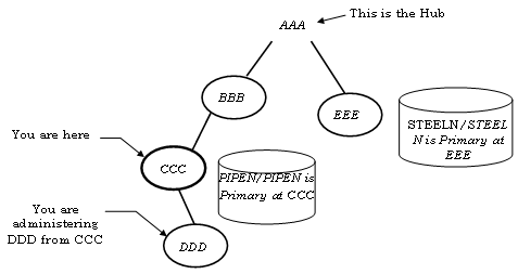

The Global database can sometimes be recovered using the daemon.
If the Global database for a location is corrupt or the network of locations has changed, it cannot be recovered using the daemon, since the daemon needs to use the Global database to understand the network. The System Administrator must copy this database to the required locations outside AVEVA E3Dā„¢. Refer to
Recovering the Global Database for a detailed description of this process.
When Reconfiguring or Renewing a database, you should then recover the database at all its secondary locations in order to prevent reverse propagation. This also applies if a database is replaced by one from another project. The RECOVER TO ALL command can be used to recover a database from its primary location to all secondary locations.
