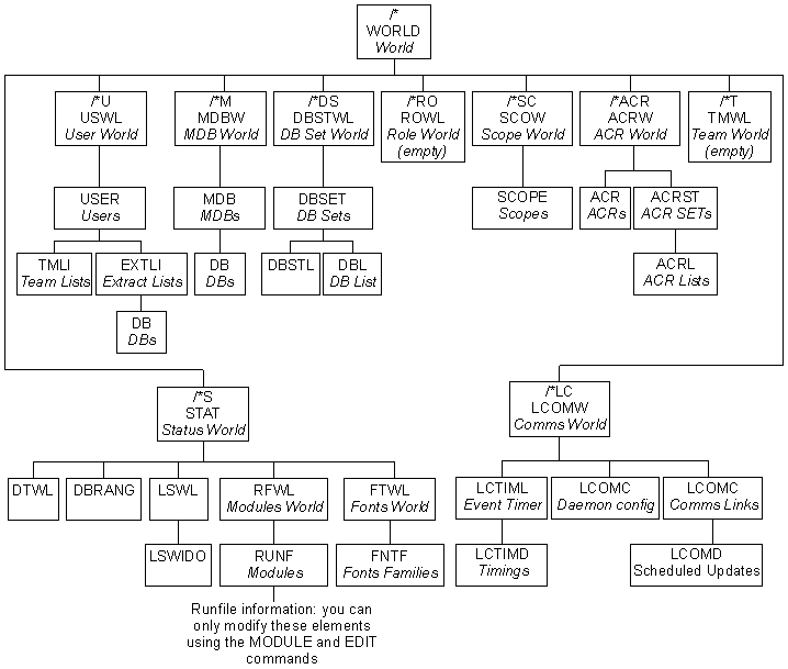

The Local System database contains the data for local Fonts, Modules, Users, MDBs, DB Sets, Scopes and ACRs: these elements correspond to those that existed in the System database of a Standard project. The communications data is held in a new LCOMW Location Communications world element. The Team World and Role Worlds still exist in the local System database, but they are empty. The Team data is stored in the Global Team World element GTMWL in the Global database, and the Role data is stored in the Global Role World.
LCOMW Element
The Location Communications World element LCOMW is called /*LC. It contains elements that describe the communications between one Location and all the other Locations with which it can communicate. The LCOMW element owns a LCOMC element, LCOML elements and LCTIML elements.
