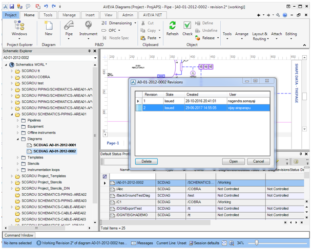

When the working revision of a drawing is deleted from the diagrams revision control, the corresponding status of the diagram will not be updated in the status control.
Open
Diagrams Revisions
, select the working copy and click
Delete
The status is still
Working

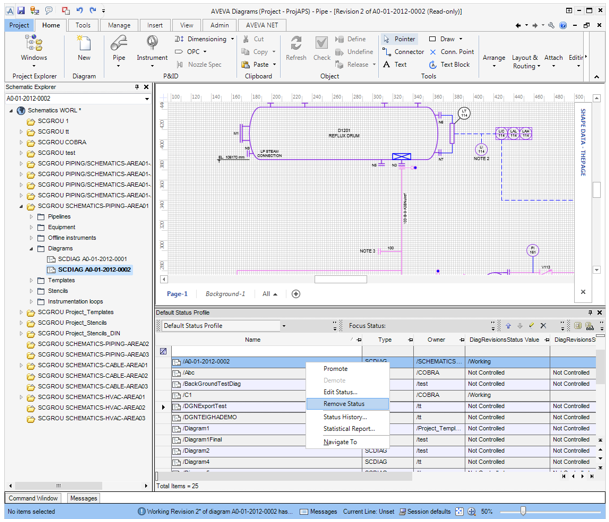

To reset the status, the user must reset the status by using the
Remove Status
context menu in the status control.

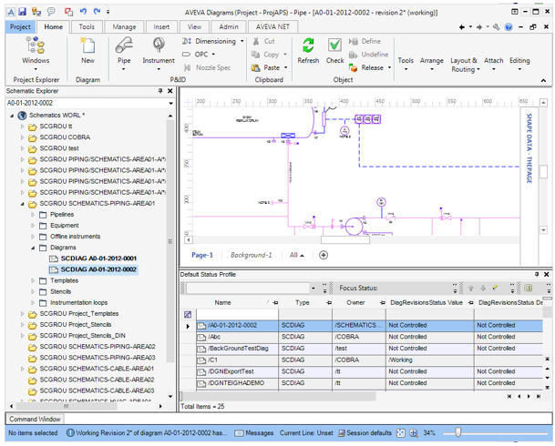

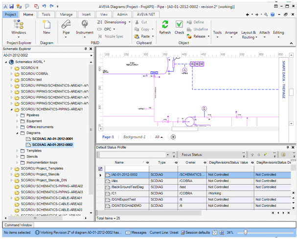

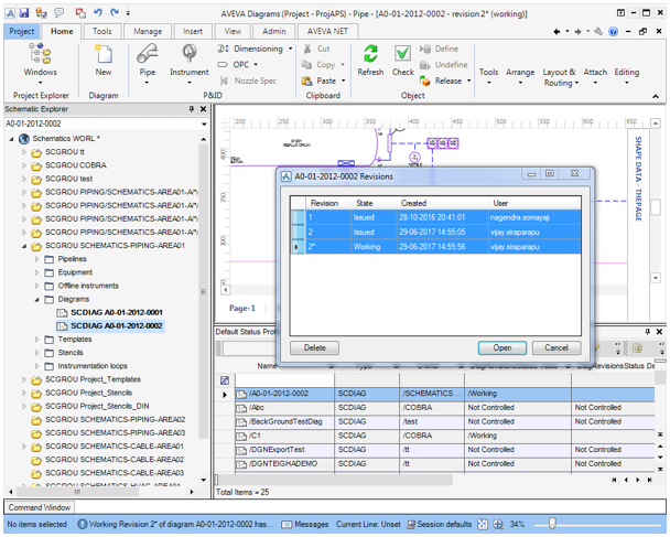

If all the revisions are selected and deleted from the revision control, then the status in the status control will be reset as shown below.
