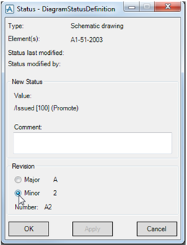

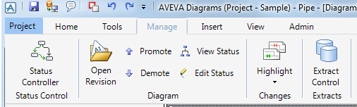

In order to make the status changes easier new commands are available on the Manage Tab / Diagram group. They allow status changes of the current, active drawing.

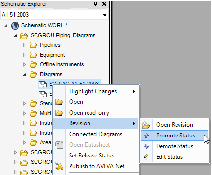

With that goal in mind also the right mouse button context menu of the SCDIAG element in Schematic Explorer has been extended with the Status Control operations.
It is possible to open revisions of a particular diagram using the Open Revision command present in both mentioned menus. This displays a dialog showing the list of revisions available for this diagram.
Additionally this dialog allows admin users to remove unwanted revisions using the Delete button. This button is disabled for regular users.
