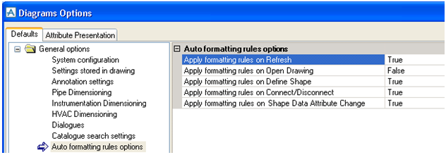

To turn on automatic executing, select the Apply on Events button. When this is checked the active rules with the Apply rule automatically on events option set are executed after different kinds of events. The events can be determined in Diagrams Options.
If the Zoom to option is on, then the zoom of the current page is adjusted to show all changed shapes.
Another option that can be set in Diagrams Options is the Message level. It specifies how detailed messages will appear in the Message Log during applying auto formatting rules. The setting can have the following values:
