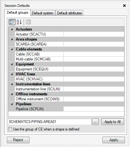

Default Groups - This panel shows the current setting for Default groups. This can be either Individual per type or Get from CE. The Default Groups setting determines at which position in the main hierarchy (schematic groups) that new items will be created. By clicking on the panel, the Default Groups dialogue will be shown (see below). In the Default Groups dialogue, the default group can be set up for each type of item. In case UDETs are being used, separate settings can be applied for each UDET type.
In case the Get Default Group from CE checkbox is checked, new elements will instead be created under the Schematic Group which is found in the CE path.
