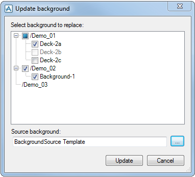

Add a selection of diagrams where the background pages should be updated. Then click the
Update background
button. The following dialog will be shown.
The above window contains the list of all selected diagrams and their background pages that potentially could be updated. It is possible to determine which background pages will be replaced, and which ones not to be replaced. By default, all background pages that can be updated will be checked.

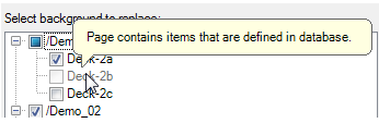

It might be that some of the background pages cannot be updated. They will be displayed, but they will be greyed out (like Deck-2b is shown above). When you move the cursor over it a tooltip with a message will be displayed. See picture below.

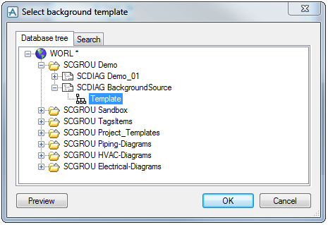

In addition, it is required to select the Source Background that will be used as a template. It will replace all background pages that are checked on the list. It is possible to type it manually using the SCDIAG name and its background page name (using space as a separator). Alternatively, you can click on the browse button and search for a proper background page.
