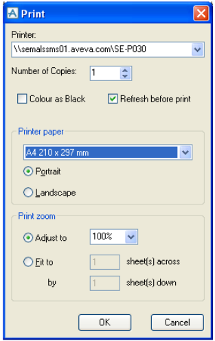

By clicking the Print button in the batch job dialogue, a Print dialog will be shown.
In the
Print
dialog it is possible to select the following:
Which printer to use
Number of copies
Print colour as black
Printer paper size and aspect
Zoom settings
Click the
OK
button and all pages of all selected diagrams will be printed on the selected printer.
