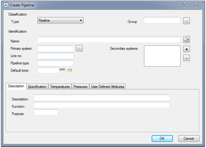

Pipelines can be created using the Home Tab > P&ID > Pipe > Create Pipeline command.
When the Create Pipeline dialogue is opened, a number of attributes will have values pre-set as follows. These are just default values and can be changed by the user.
The Type dropdown box will allow the user to create pipelines using derived UDET types.
Use the Auto name button, located next to the Name text box, to reset the name of the Pipeline, if necessary.
The pipeline name can be automatically constructed by using the Autonaming function. In order to provide feedback on the autonaming while the dialogue is open, a pipeline element is actually created as the dialogue is opened. In case the user clicks Cancel, this pipeline element will be removed again.
