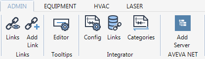

To setup a server, on the Admin tab, in the AVEVA NET group, click Add Server to display the Dashboard Server Selection window. Refer to Dashboard Server for further information.

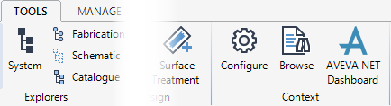

All the other commands are available in the Context group within the TOOLS tab and on the Associated Documents window accessed by clicking Browse. Refer to Associated Documents for further information.
Click to display the Configuration window. Refer to Configure for further information.
Click to open the AVEVA NET Dashboard. Refer to AVEVA NET Dashboard for further information.

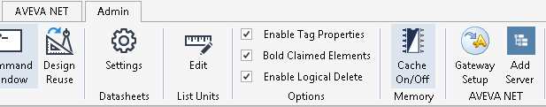

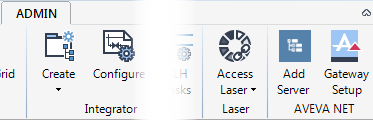

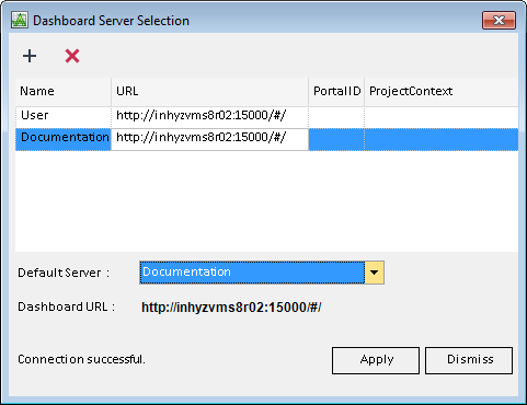

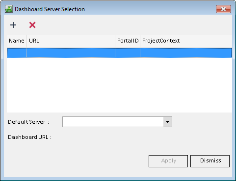

To use Design in Context you need to set up a server connection with AVEVA NET Dashboard in order to access the data. To set up a server connection, click Add Server to display the Dashboard Server Selection window.
Click Apply to accept the entry or Dismiss to close the window.
When you have added a server, the Dashboard Server Selection window will display that the connection was successful.

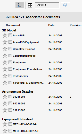

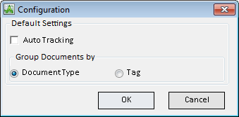

If the Auto Tracking check box is selected, the current element is displayed in the Search field of the Associated Documents window and an automatic search will be performed and the results displayed.
If the Auto Tracking check box is not selected, the current element is displayed in the Search field of the Associated Document window but no automatic search is performed. To perform a search you must click Search.
If Document Type is selected, all of the Tags are grouped and displayed in different groups for a particular Document Type.
If Tag is selected, all of the Document Types are grouped and displayed in a list.

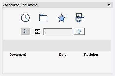

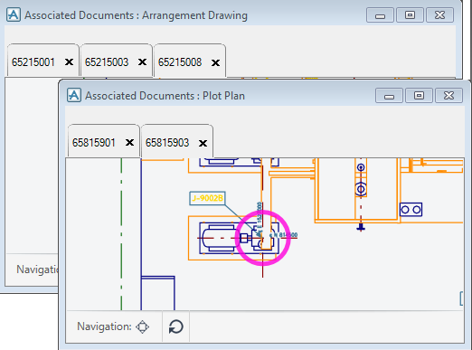

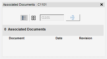

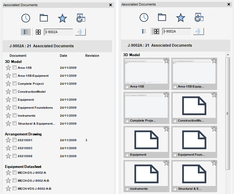

The Associated Documents window allows you to do all the navigating activity for Design In Context.
On the TOOLS tab, in the Context group, click Browse to open the Associated Documents window.

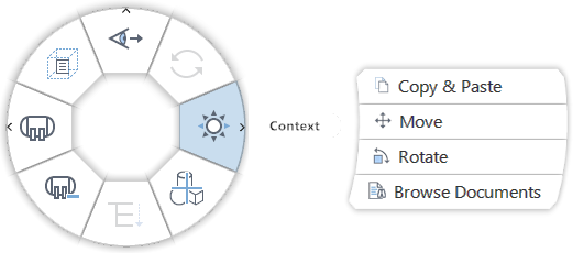

On the TOOLS tab, in the Context group, click Browse to open the Associated Documents window or by right-clicking in the Graphical View to display the PowerWheel and selecting Context > Browse Documents.
On the AVEVA NET tab, in the Context group, click Browse to open the Associated Documents window.
In AVEVA Diagrams™ and AVEVA Engineering™ the Associated Documents window can also be opened in a specific mode by clicking either Recent Documents, Collections, Favourites or Restore from the Manage group on the AVEVA NET tab.

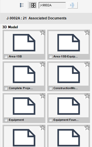

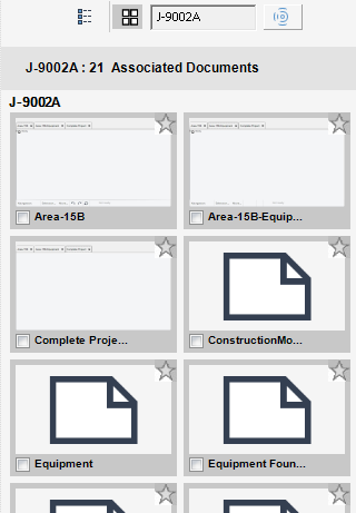

The current item selected in the application will be displayed in the Search field. Click on to list the documents related to that item. If the Auto Tracking check box has been selected on the Configuration window, the current element is displayed in the Search field of the Associated Documents window and an automatic search is performed and the results displayed.

To add documents to an existing or a new collection, select the check box(es) preceding the document name in the List View or select the check box(es) located bottom left in the Thumbnail View.

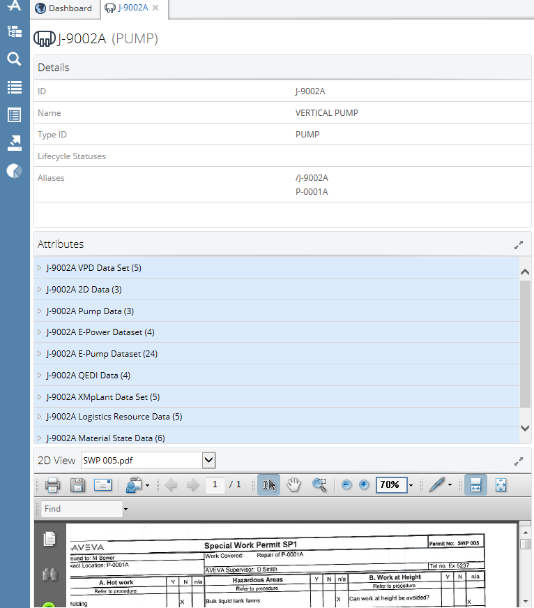

The currently selected item in the explorer can be displayed in the AVEVA NET Dashboard by clicking AVEVA NET Dashboard.
In AVEVA Everything3D™ 2.1 the AVEVA NET Dashboard can also be displayed from the PowerWheel (Ctrl+Right Click).
