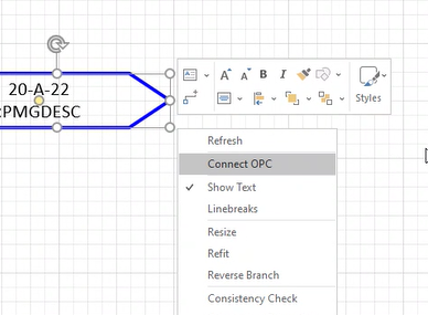

An outgoing OPC can be connected to an incoming (or vice versa) using the Connect OPC command in the shape right-click menu.

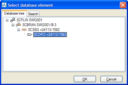

This command will bring up a Selection dialogue (Standard DB Browse Dialogue) where all unconnected OPCs of the opposite kind will be listed.

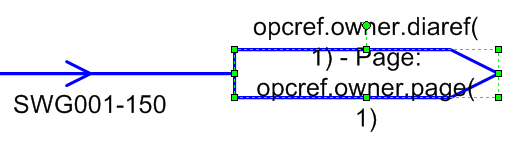

The shape text shown in the OPC can be controlled by the Attribute Presentation Notation. Refer to Attribute Presentation Notation in Chapter Appendices for further information. It is for example possible to show the name of the drawing and the page of the OPC that the current one is connected to by using the following format: [opcref.owner.diaref(1)] - Page: [opcref.owner.page(1)].
